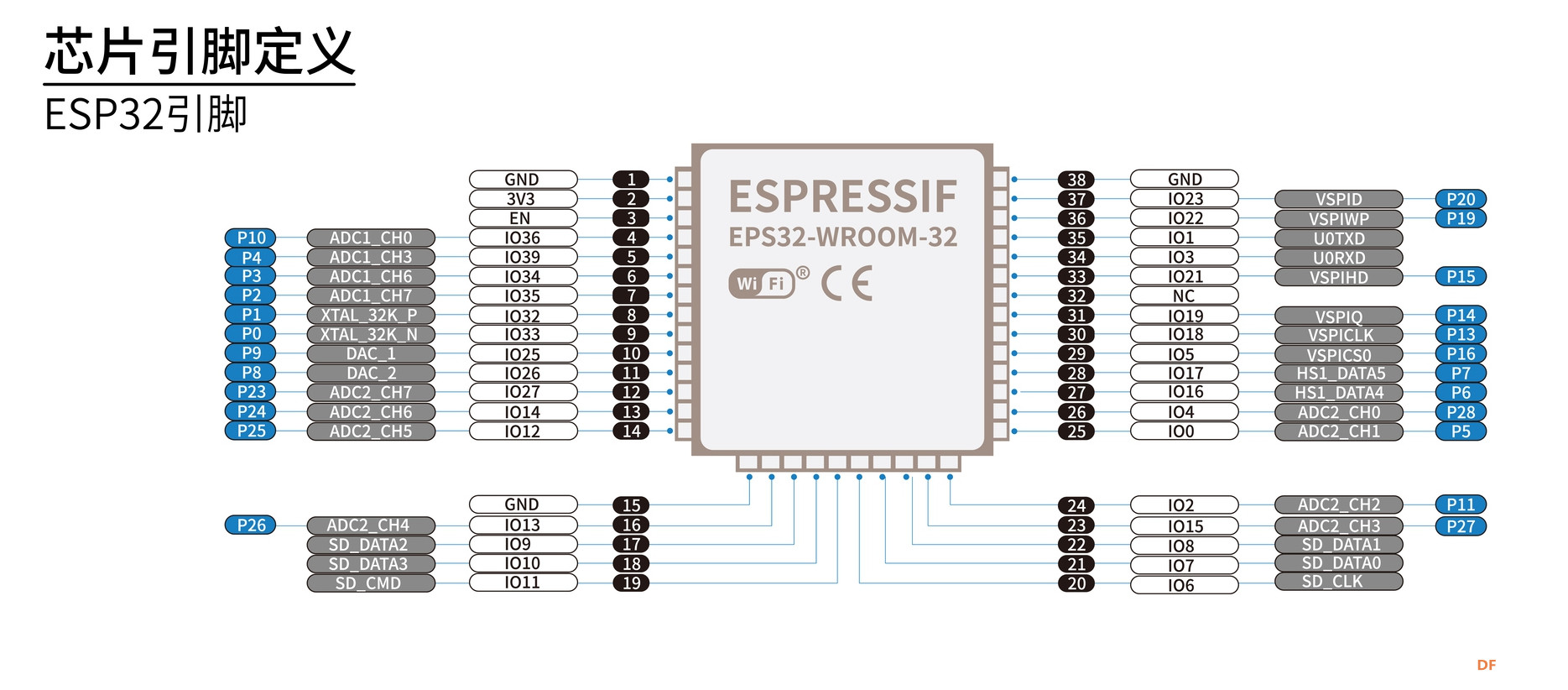

查看柔性屏及掌控板IO定义,红线连正极、黑线连负极、蓝线连13、绿线连14
ESP32引脚定义
查看ESP32引脚定义对应IO18 19,初始化屏幕
SoftwareSerial          SoftwareSerial1(19, 18);
DFRobot_SerialScreen771 screen;
screen.begin(&SoftwareSerial1);
