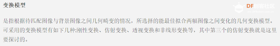

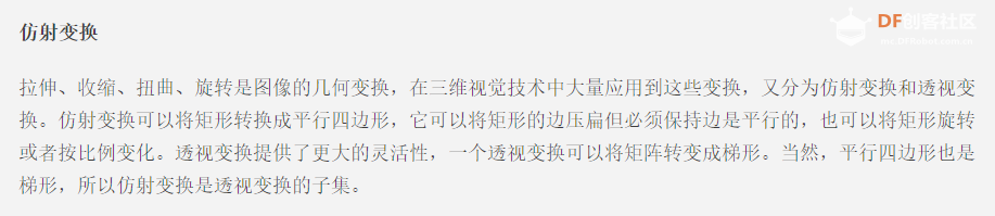

## 实验程序之一:affine 仿射变换(实时缩放)

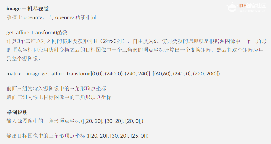

matrix = image.get_affine_transform([(0,0), (240, 0), (240, 240)], [(60,60), (240, 0), (220, 200)])

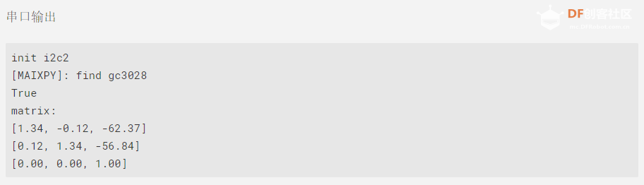

print(“matrix:”)
print(“[{:.02f}, {:.02f}, {:.02f}]”.format(matrix[0], matrix[1], matrix[2]))
print(“[{:.02f}, {:.02f}, {:.02f}]”.format(matrix[3], matrix[4], matrix[5]))
print(“[{:.02f}, {:.02f}, {:.02f}]”.format(matrix[6], matrix[7], matrix[8]))

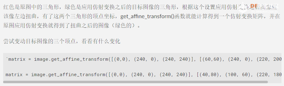

`matrix = image.get_affine_transform([(0,0), (240, 0), (240, 240)], [(60,60), (240, 0), (220, 200)])
matrix = image.get_affine_transform([(0,0), (240, 0), (240, 240)], [(40,80), (100, 60), (220, 180)])`

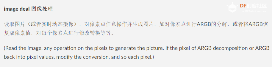

#实验程序之二:image deal 图像处理(深色浮雕)
